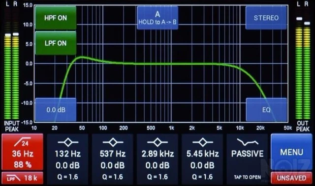

– stereo 12 or 24dB/oct high-pass filter with adjustable cutoff frequency (10Hz – 240 Hz; extended
to 6Hz with the resonance enabled)

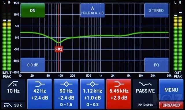

– four stereo parametric filters with 15dB boost/cut range, variable Q (0.2 – 7):
– EQ1: 22Hz – 470Hz (bell/shelf)
– EQ2: 90Hz – 2kHz (bell)
– EQ3: 480Hz – 10kHz (bell)
– EQ4: 1kHz – 23kHz (bell/shelf)

– stereo, 12dB/oct low-pass filter with adjustable cutoff frequency (2 – 38 kHz)

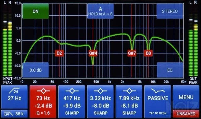

– Frequency Search, Gain Lock, Note and Auto-Q functions

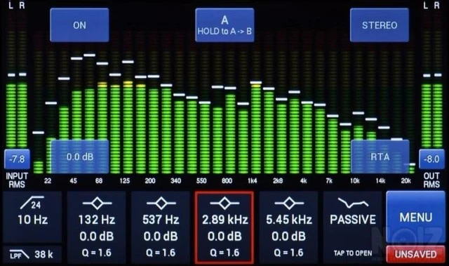

– on-board measurement of PEAK/RMS levels and RTA analyzer
– on-screen live representation of the equalization curve
